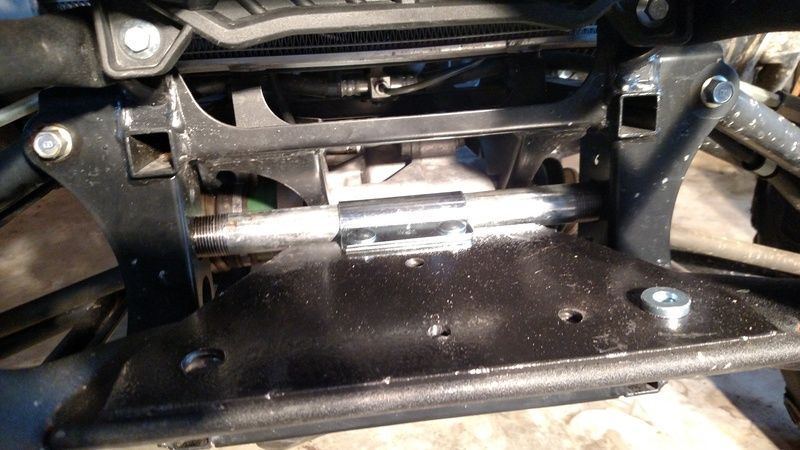

More pics to follow but here is the mounting plate I fabbed up. I just have the factory front push bar. The mounting point on that bar is pretty wimpy. It may have been fine for my Harbor freight 2500# winch but when this burns up I want to go with a 4-5000# unit. I figured I might as well have a good solid mount. The Wolverine frame between the upper & lower A arms has a hole on each side that fits a 3/4" water pipe very nicely. I used a 11 1/4" long piece of 3/4" galvinized pipe threaded on each end. I inserted the pipe through the holes and screwed a pipe cap on each end. I then put a 3/4" repair clamp over the pipe and bolted it to the bracket I made. It is rock solid.
